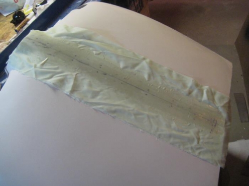

Glassing the top seam
I needed to glass the top joint of the cowl, so I wet it, added 3 layers of glass (each strip wider than the previous), and pressed it out with peel ply.
Peel ply over 3 layers of glass.
