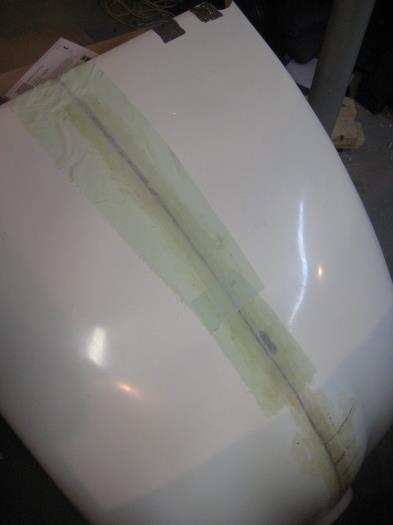

More fiberglass on cowl
Added fiberglass to the lower portion of the cowl. This time I used peel-ply (light green in the photo) so I could use a scraper to smooth out the glassing. This should give a smoother finish with less resin.
More fiberglass. Peel ply is light green.
