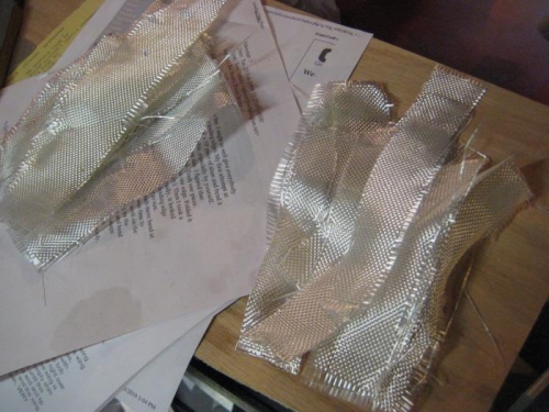

Started glassing the upper cowl
- Cut short strips of fiberglass mat

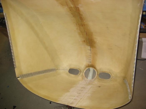

- Roughed up the surfaces to be fiberglassed, with 80 grit sandpaper. Blew clean with air hose, then cleaned with mineral spirits and let dry.
- Installed overlapping glass strips, avoiding the clecos holding it together.
Strips of fiberglass mat cut and ready to install.
Roughed up the surfaces to be glassed.
Horizontal strips of glass, missing the clecos coming through.
