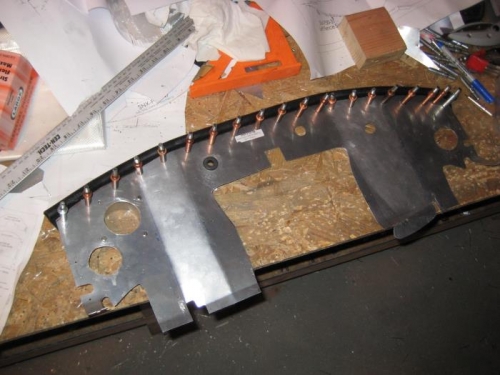

Brief Description:  Rear baffle seal
This baffle stuff takes a long time!
- I put the lower cowl back in place to see how well the modifications (extensions) to the lower baffles worked. I could have made some of it even a little deeper, but I think there is enough flexible baffle material depth to make it work.
- I put the right upper cowl on to check things there. Even though I cut the baffles down more before I put on the flexible material, it's still maybe a little too tight to the cowl. But maybe that's good, so the air pressure does not create a gap.
- Then I checked the upper left cowl for clearances. I marked the metal baffle materials for some more adjustments (cutting).
- Removed the upper cowls, removed the rear and left baffles, and cut them as marked.
- The rear baffle had already been adjusted, so I went throught the process of installing the flexible material, per photo 1. Got as far as updrilling.
Rear baffle seal ready for deburring
