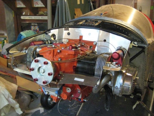

Extend baffles
Several of the baffle sections were too short to get the flexible baffle seals to meet the cowl, so I'm having to extend the baffles in several locations by 3/8" to 1/2". In photo 1 you can see a series of extensions yet to be riveted.
Baffle extensions being fitted.
Extended lower baffles at center and left.
