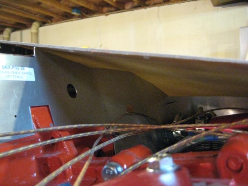

- With the baffles in place on the engine, I laid over the right cowl and pinned it in place. The instructions say to leave about 1/2" between the baffles and the cowl. My forefinger is about 1/2" thick, so I ran my finger along the top of the baffle. Where my finger fit, the baffle was the correct height. Where my finger would not fit, I made a mark on the baffle to start cutting there.

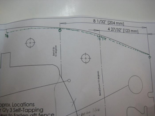

- Using the drawings that come with the baffle, I noted what needed to be cut, where (photo 2). It's better to cut too little than too much, so I always noted about 1/8" less than I thought.

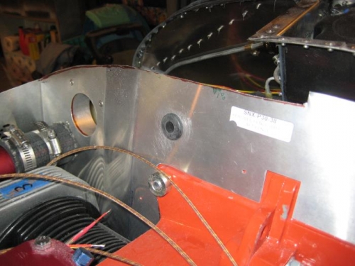

- Photo 3 shows one side of the baffle cut. You can see the other side has not yet been measured and cut.
View of uncut baffles under cowl
Noting on the baffle drawings, what needed to be trimmed where.
I cut the baffles in-place.
