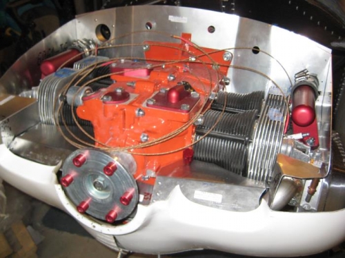

- Made the 4 attach angles (photo 1) for the side baffles, to attach the baffles to the engine case.

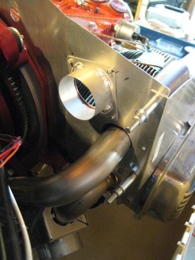

- Riveted the Scat tube fitting to the back of the rear baffle (photo 3).
- With the baffles in place, put on the lower cowl. Put on the upper cowl, too, just to take a peek in the cowl inlets, to see how much trimming will be needed of the baffles. Not too much, it looks like.
- Tomorrow will put on the upper 1/4 cowl pieces in place to work on the baffles on one side of the engine at a time.

Forward baffles riveted; side & back baffles cleco'd
Air outlet at back of baffle, for cabin heat.
