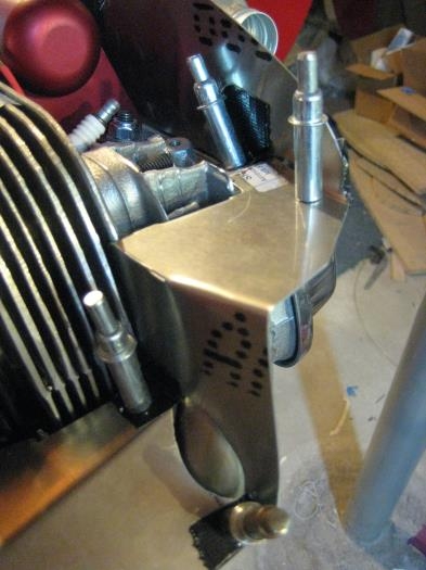

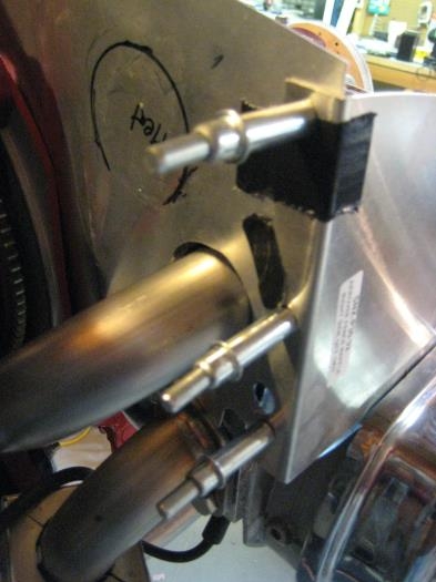

- While still on the engine, drilled pilot holes through the baffle pieces and cleco'd them together.
- Removed baffles and trimmed a few more areas.
- Used a fly cutter to cut out the hole in the rear baffle, for the cabin heat pressurized air. I have a hose fitting that will get riveted to the back side of the baffle.
- Drilled the 4 mounting holes for the aforementioned hose fitting.
Drilled pilot holes in baffles and cleco'd
More cleco'd connections
Lower section removed intact, with clecos in place.
