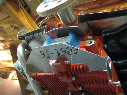

Brief Description:  Learn baffle locations
Decided to figure out where all the baffle pieces go. The baffle instructions are 99% non-existant! They show some photos, with no part number, no instructions, and VERY incomplete photos. Of all Sonex's documentation the baffles are the WORST.
I had to go to Carl Orton's web site to look at his photos to figure out what went where.
More pictures on the next page.

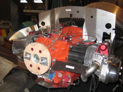

Rear baffle is
Rear baffle is "up" because the intakes are still attached.
These don't meet the exhaust well AT ALL, so it will take a lot of massaging.

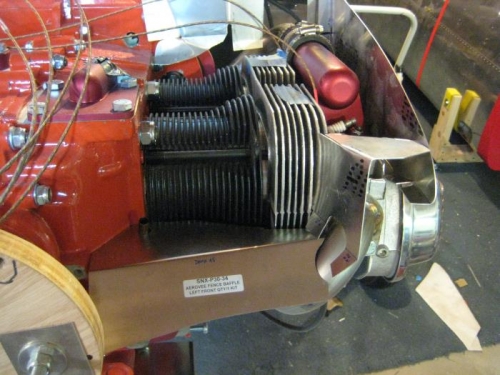

Baffle instructions never show this piece. Found out it goes here, from another builder's web site.
