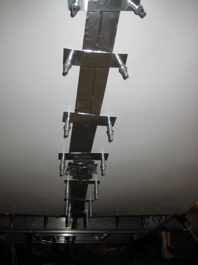

Prep cowl for fiberglass
Took the top cowl off so I can get inside. Covered up the seam at the bottom of the cowl, with aluminum tape. The resin doesn't stick to aluminum.

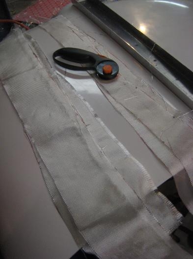

Then cut 2" and 4" wide strips of fiberglass cloth the use along the bottom seam.
Aluminum tape along the seam at the bottom of the cowl.
I cut 2" and 4" wide fiberglass cloth strips.
