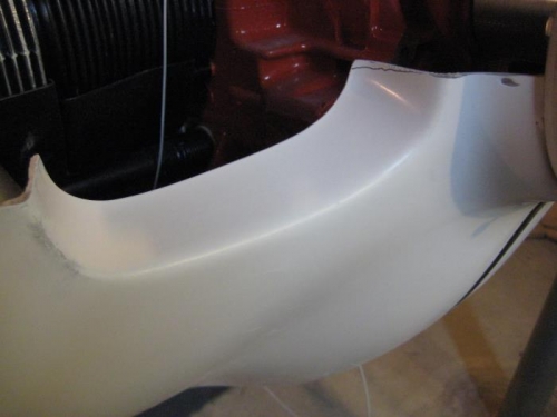

- With the upper cowl off, I trimmed the inlets to size, then sanded them smooth (photos 1 & 2).
- Put the upper cowl back on the aircraft so I could mark (on the lower cowl inlets) the exact point that the upper cowl inlets (now trimmed) met. That way the inlets woudl be even and continuous.

Upper cowl inlet trimmed.
