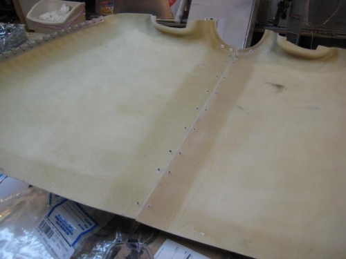

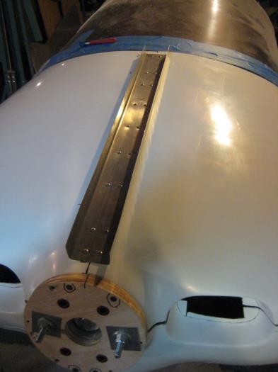

Connect upper cowl halves
- A little more trimming, then
- Duct taped the upper halves together.
- Made a channel (for rigidity) and riveted it to the upper cowl halves while they were in place on the aircraft.

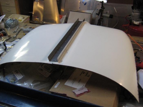

- Now I could remove the cowl and prepare it for fiberglassing together.
Channel riveted to upper cowl halves.
From underneath, after removal from the aircraft
From the back, with the channel in place.
