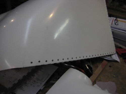

- Updrilled the cowl/hinge holes.
- Removed the hinges, deburred, cleco'd then riveted them in place.

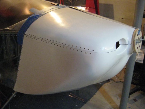

- Test fit the cowl on the airframe. Fits pretty nicely!
- I still need to do the bottom edge of the cowl, which is a real pain, since I need to drill 10 holes in the stainless firewall!
- The good news is that when I pick up the lower edge of the cowl and place it against the fuselage (where it will be when done) the gap I had experienced between the prop hub and the bottom cowl went away!

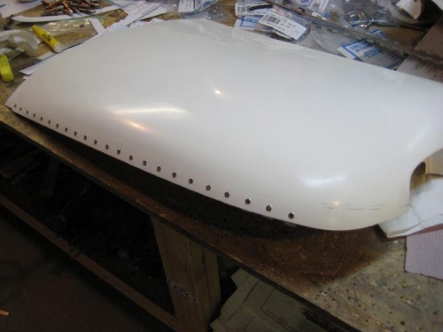

Top half riveted
Top half riveted
Bottom half (upside down) riveted
