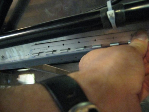

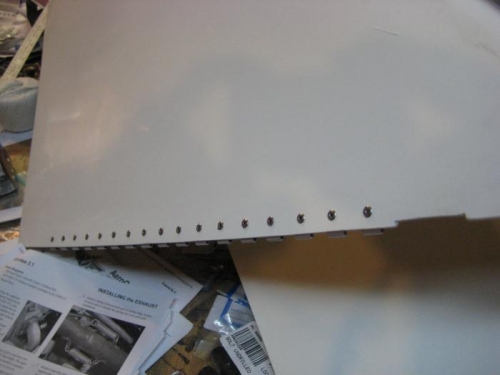

Continue right cowl
- Sanded lower cowl edges
- Installed the hinge with rivets
- Made the 2 hinge halves for the lower cowls
- Measured for the locations of the hinge halves, then stuck them in place with double-sided tape.
- Marked the hole locations
- Started trying to drill with a titanium bit, but didn't make any progress. I think the bits are old. I just ordered 25 cobalt bits!
Side hing half riveted in place.
Lower hing half held in place roughly where it will get installed.
