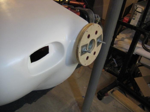

- Feeling under the weather, so just cut the hole in the bottom corner for the gear leg. Made it bigger than it needed to be. I can always throw in a fiberglass patch later if I think it's needed.

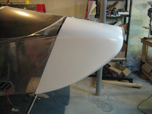

- Cowl does not fit flush vertically to the back of the prop hub spacer. The bottom of the spacer is a good 1/2" beyond the cowl. Even if I shimmed the top two engine mount bolts (to tip the engine downward), it would never make up that much distance. I'll do some more fitting before I decide what to do, but I may have to cut the bottom of the cowl so I can pull the front flange to the hub, and then patch the resulting gap with fiberglass.
At prop hub
At prop hub
Roughly at fuselage (lots of fitting and cutting to go).
