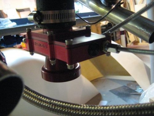

- Finished clamping the throttle cable in place, closed up the AeroInjector (AI), and reattached the AI to the intake pipe.

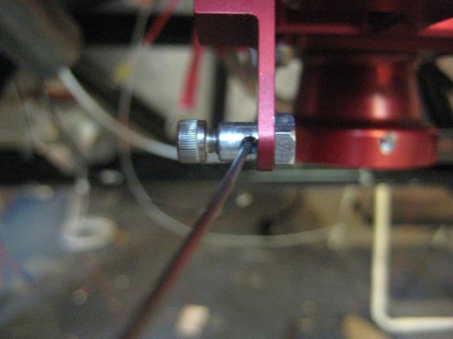

- Installed the mixture cable per the AI instructions. However, when I tighten the screw of the swivel nut against the wire, the wire is pressed against the mixture arm and the cable binds. I tried loosening the screw, but if I loosen it enough to allow the mixture cable to swivel free, the mixture cable just slides out of the hole.
- In photo #1 you can see that the hole is tight against the arm, so there is no way to prevent the wire from being pressed against the arm.
I have asked Sonex for suggestions.
Mixture cable through swivel nut. See how close the hole is to the arm.
From the rear, the fuel line left, throttle cable right center; mixture above that.
