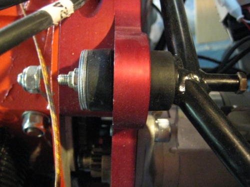

-. The engine mount grommets never seated properly when we hung the engine, and that was keeping me from progressing with the cowling, electrical connections, and throttle/mixture connections.
- So I had a mechanic-friend come over to help me wrestle the grommets into the engine mount. His first quesion was, "have you tried soapy water?" I hadn't.
- So in an example of brains over brawn I wetted the grommets with soapy water and we got them all to seat with little effort!
- Of course, after my friend left I realized (re-reading the instructions again) that I needed more than 1 washer at the front grommet. The instructions say at least 1/8" thickness of grommets. So I loosened each mounting nut one at a time, added two more washers per grommet (see photo #1), added soapy water again, and re-tightened everything.

Rubber engine mount grommets
