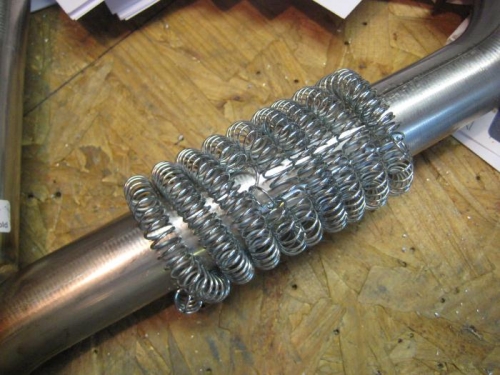

Heat Muff:
- Bought a package of 2 screen door springs at Home Depot.
- Wrapped them around the exhaust pipe and hooked their ends to the adjacent coils.
- The coils wanted to unwind, so I wired the far ends together with stainless wire.
- Put the heat muff box around the springs and exhaust, and riveted the box closed.
- I still need to put on the stainless hose clamps to hold it on, but I won't do that until I locate the exact position of the muff, which will be after I locate the EGT probes.

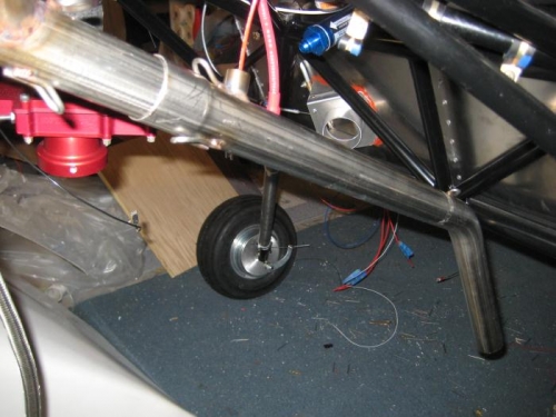

Exhaust Pipes:
- The ends of the primary exahust pipes are too long for the second pipes, so I measured where to cut so the secondary pipes would not touch the engine mount before turning downward.
- Cut the ends of the primary exhaust pipes with a hacksaw. Went through like butter, no problem.
- Had to use a pipe expander to slightly enlarge the expanded ends of the secondary pipes. Sonex said it was normal for them to be slightly undersized, but it cost me $20 to buy a cheap pipe expander. It broke the second time I used it, but it worked well enough to get the job done before it did.
Screen door spring, expanded and wrapped around the exhaust pipe.
Heat muff installed over the springs and the exhaust, and riveted.
After cutting and expanding the left exhaust in place.
