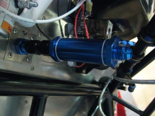

Test fit the new micro-screen, aluminum, in-line fuel filter (blue thing in photo #1). Like many people I'm not installing a gas colator. I have a bulkhead fitting comming through the firewall, to a straight swivel fitting, and then to the fuel filter. From there I will have a braided hose go to the AeroInjector (carb).

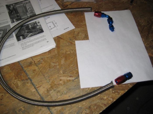

Photo 3 are the 90 deg swivel fitting, -6 to NPT adapter, braided hose, and a straight swivel fitting, that need to be sized and made into a fuel hose.
Reusable aluminum fuel filter.

Parts for the final fuel hose.
