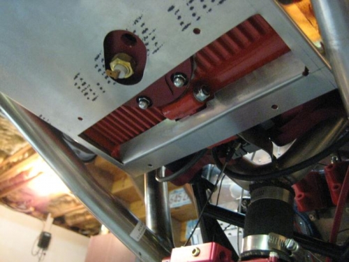

Brief Description:  Oil Cooler Baffle
- Enlarged the hole in the oil cooler baffle to also expose the fitting where the oil return is to go.
- Cut out a large slot in the oil cooler baffle, with an integral fence at the back side, to deflect air down across the oil cooler (oil cooler not in photo #1).

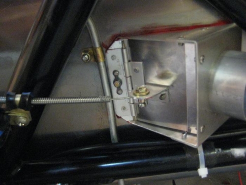

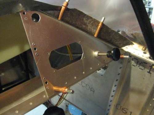

- Installed the knob/cable for the cabin heat box. In photos 2 and 3 the knob is pulled out, and the flapper valve open, to allow warm air into the cabin.
Oil cooler baffle with dam at the back side.
Cabin heat box in full OPEN position
Cabin heat knob to OPEN position
