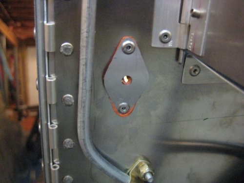

- Drilled a hole in the firewall for the heater box control cable to go through,
- Added a firewall gasket and cover for heater box cable to come through (photo #1).

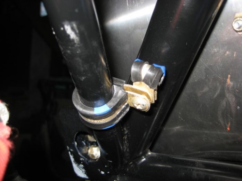

- Attached two Adel clamps: one to the down-tube of the engine mount, and a smaller one to that, to accept the heater control cable. A mini pair of vice-grips helped hold both Adel clamps together long enough to get the nut started.

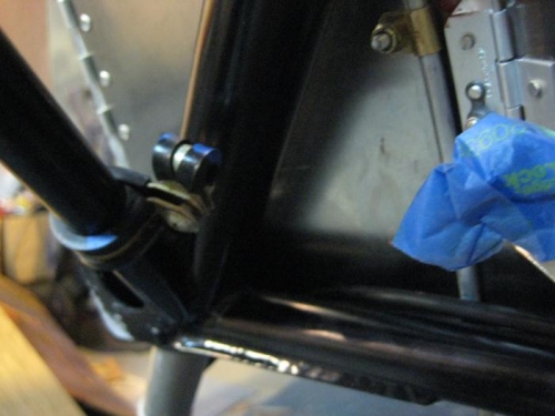

- In photo #3 you can see the small clamp is in line with the heater box flapper valve fitting (the fitting and its nut/bolt are held together temporarily with the blue tape). This will allow the cable to have a nice straight shot to the heater box.

Firewall gasket and cover for heater box cable
2 Adel clamps on one of the engine mount tubes. The small clamp will take the control cable.
Another view of the two Adel clamps. Heat box is to the right with the blue tape.
