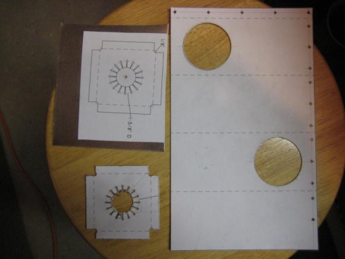

Using a design my D. Weber I drew the patterns in my CAD program, glued to .025 aluminum, and cut and drilled most of the pieces (photo #1).

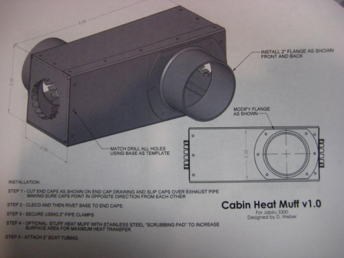

Photo #2 shows the 3D veiw by D. Weber of the end result of the muff. The exhaust pipe goes through the narrow holes with the tabs, and the SCAT tubing for the air goes to the larger flanges.
Parts in progress, of 0.025 alum.
This is what it will look like.
