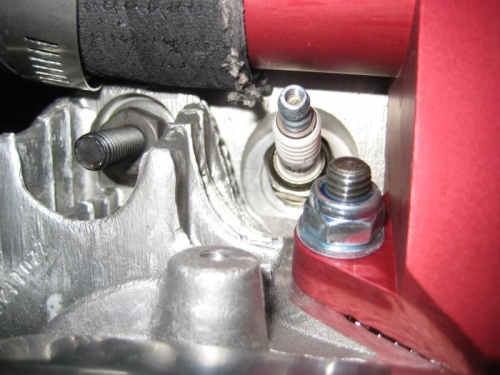

Installed the upper and lower spark plugs. Really tough to get the spark plug socket past the rear intake manifold. This is probably why in the installation manual the installation of the spark plugs goes BEFORE installing the intakes. But if I ever have to check or change the plugs, I don't want to have to pull the intakes.

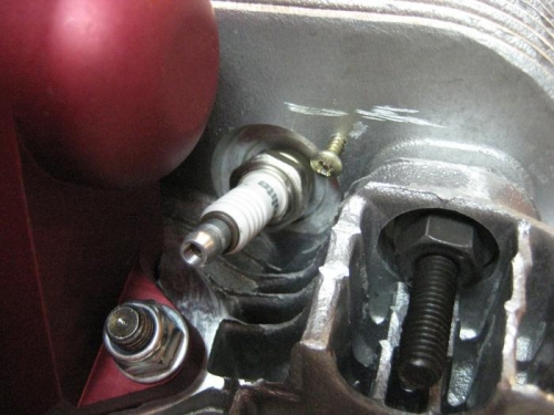

Per the AeroVee instructions I drilled holes in the heads for the Cylinder Head Temp (CHT) probe screws. The forward two were accessible and easy. The back two were difficult to say the least, due to the intake manifolds (photo 2). The instructions for the probes are separate from the AeroVee manual, and neither said anything about drilling and installing the screws BEFORE the intake manifolds go on.
Upper spark plug + screw for CHT probe
At the rear location, the screw is barely visible behind and to the left of the spark plug.
