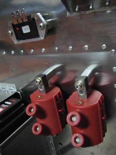

Finished setting all the rivnuts that I could. The remainders I can't do until I remove the engine mount, so I can drill the final holes (the engine mount doesn't let the drill fit in there).
Installed the voltage regulator and both coils.
Then installed the cabin heat box. I used RTV to seal between the box and the firewall. The two anchor points provided by the box are NOT enough. The firewall flexes too muich, and the surface of the box is just not flush enough. I think when I take the engine mout off, I'll add some rivets to really set it in place.
Voltage regulator above, and coils below.
