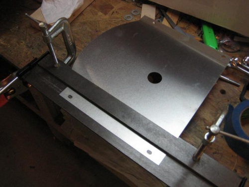

In photo 2 I bent the two sides of the lower baffle with my small brake.

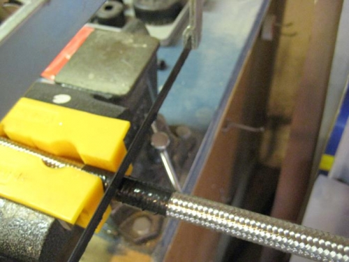

Now I need to make (2) 12" long braided hoses with AN fittings. A few wraps of duct tape around the hose, and good use of a hacksaw, and you get a clean cut (photo 3). I then got 2 of 4 fittings installed.

Using my small brake to bend the sides of the lower baffle that holds the oil cooler.
Making more braided hose. Duct tape and a hacksaw make smooth cuts.
