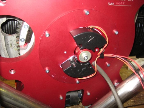

Installed the alternator per the instructions, including checking to make sure the stator and the magnets are not scraping together when the crank turns. There was no interference so I made the final installation.

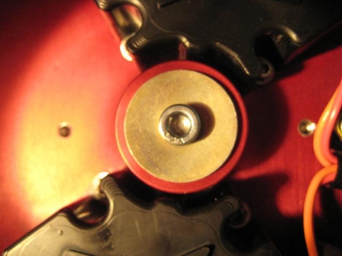

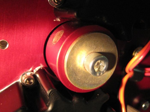

I then wanted to set the timing. The instructions clearly show a timing mark on the alternator shaft, but as you can see in photos 1 and 2, it is NOT on my alternator! So I have no way to set the timing. I need to contact Sonex.
Alternator installed
Note there is NO timing mark on the shaft of the alternator. There should be.
