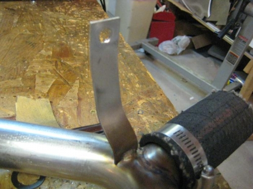

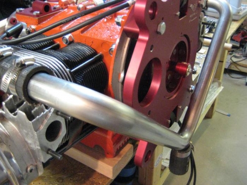

So I went onto the intakes. You have to drill our own hole in the stainless attachment strap (photo #1), and bend it to make sure it goes around, and doesn't touch, the lower magnetron. Then it attaches with one of the engine case bolts (photo #3).

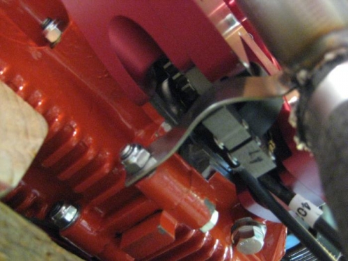

The "Y" intake collector then goes in the flexible hose fittings that also got installed tonight, on the intake manifolds (in photo #2).
You have to drill a hole in the attachment, then bend it to fit.
The intake
The intake "Y" goes in place...
with the bent attachment going around the magnetron, and to the engine case bolt.
