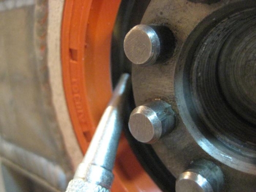

3. Installed the oil seal at the flywheel-side of the crank. OK, here we go again...
The manual and DVD say to put sealant on the ring and tap it into place. Unfortunately when the seal is FLUSH with the case, there is a very large gap left between the seal and the case (see where I'm pointing in photo #1), and I don't know if that's correct. Neither the manual, nor the video, nor in any book, did I see any note about HOW FAR to seat the ring. I set it flush with the case, based on ONE single picture I could find of someone else's AV construction. It seems "wrong" to leave the large gap behind the seal. The manual should tell us.

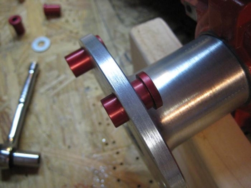

4. Started to install the prop lugs, but they fit WAY, WAY tight, and my sockets were starting to strip the nut I was using to pull the lugs into place, so I stopped. I will get some extra bolts and nuts to use, tomorrow.

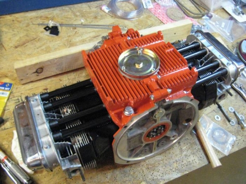

5. Installed many of the accessory plates that cover various openings in the case. See photo on next page.
Oil seal with large gap behind.
Off the engine stand and on the table.
Started to install the prob hub lugs.
