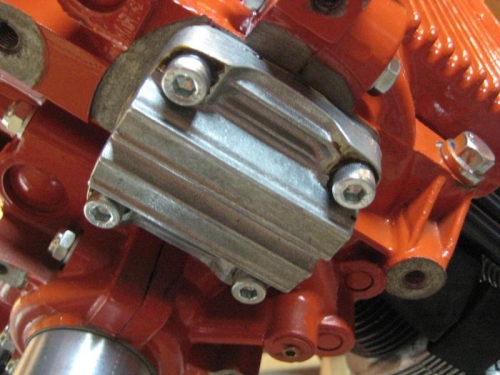

Oil pump:
1. When putting the cover on the oil pump the manual says to put permatex AND the paper gasket in place. But in the video I don't see a paper gasket. The VW book says use the paper gasket, but does not say anything about the permatex gasket.
2. Manual says to torque to 14 ft/lbs, but the bolts supplied (see photo 3) are allen keyed, so there is no way to torque.
3. VW book says to use washers under the bolts, but there are none supplied. Sonex video SHOWS washers going on, but doesn't SAY anything about them.

Finally, installed the oil pump (photo 3). Be SURE to align the pump hole with the case hole, per the manual.

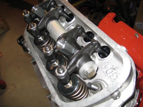

2nd rocker assembly in place.

Oil pump in place.
Oil pump in place.
