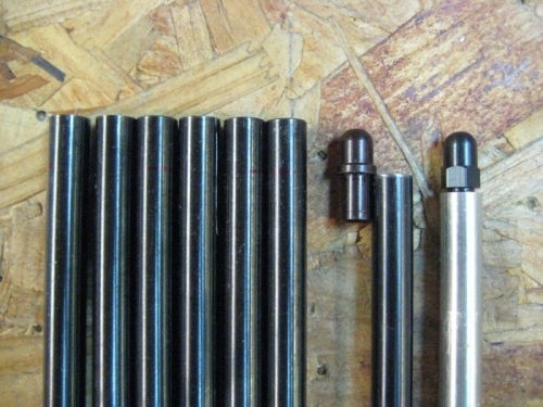

Photo 1 shows the pushrod measuring tool, a cut pushrod, and the tip that the pushrod is being measured for.

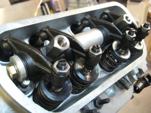

In photo 2, a complete head assembly with pushrods and rocker assembly.
Photo 3 is the OTHER head. I had to cut more than 3/8" off each stud, but this time I knew I needed to take that much off, so I cut all 3 of the interfering studs as short as I could.
Others have said they really enjoyed building the engine. I was planning to feel the same way, but I don't. There is way more fiddling and hacking than I had expected. The video is woefully lacking in real information, and the manual is not much better. For instance, I had to watch the EAA video of Jeremy showing how to measure and cut the pushrods, to understand what I needed to do. Why isn't that information in the manual, or on the video?

Measuring tool at far right, cut pushrod to its left and one of the tips to the right of that.
Pushrods and rocker assembly installed, and nuts torqued.
The cut studs on the OTHER head. These I cut down further than on the other head.
