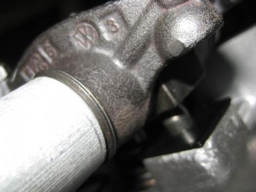

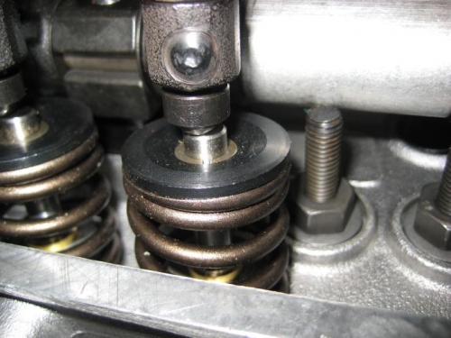

2. Next I started on the rocker arms. The manual says to check for interference with the head studs. INTERFERENCE is an understatement! In photo #1 you can see one of the studs hitting the rocker assembly. In photo #2 you can see a minimum 3/8" gap betwen the rocker block and the seat! The manual says to "trim" the studs.

Head stud contacting the rocker assembly.
A full 3/8
A full 3/8" gap to make up.
