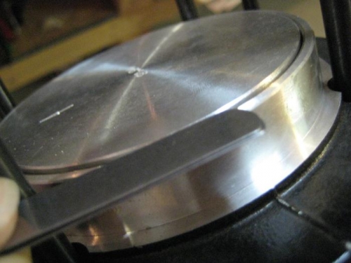

Measuring the deck height

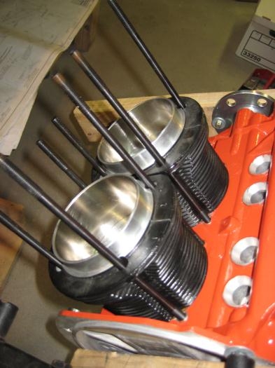

2 cylinders in place
