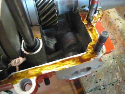

Photo #1: Installation of a thin layer of Permatex Form-a-Gasket #3 on all mating surfaces.

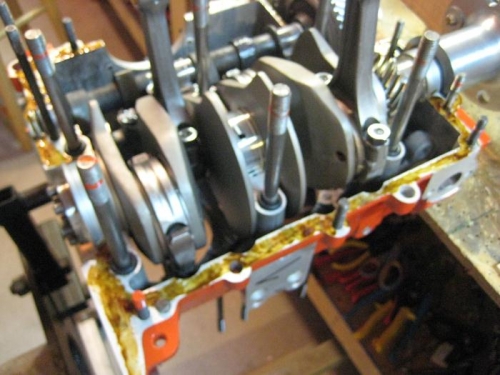

Photo #2: Another (blurry) view of the case with the Permatex.

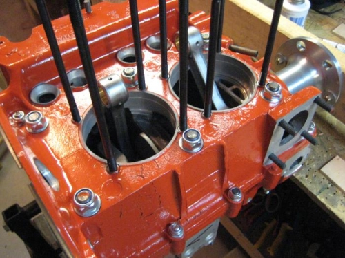

Photo #3: The case halves assembled and all the nuts and bolts installed and torqued.
Cylinders are next!
Permatex Form-a-Gasket thinly applied to the mating surfaces.
A slightly blurry shot of the Permatex.
The case halves assembled and all the fasteners set and torqued.
