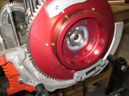

Brief Description:  Crank & cam installation
Temporarily installed (sort of) the flywheel. I actually need an impact wrench and a 36mm socket to get it on.
This was NOT a fun task. The video shows this thing sliding on smoothly. Mine did not. Not at all! I polished down the 8 pins like Sonex said, but it didn't help. There was NO getting this thing hand tight. It will take the wrench.
Flywheel partially in place.
