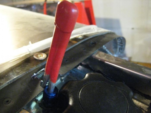

My fuel vent, which I made a long time ago, did not fit right since the notch in the cowling strap (the black thing in photo #1) was not big enough. So I used a Dremel cutoff wheel, some needlenose pliers, and some files, to make it bigger and get the vent in there (photo #1).

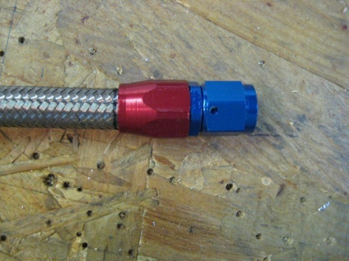

I decided to use flexible hose for my fuel system. The rigid line I had made to go from the tank through the firewall, was not giving me a warm-and-fuzzy. All those ridig connections in a vibrating airplane, and right where occupants can kick it.
It's tough to figure out what fittings and hose you actually need. I got some great help from several people on the SonexTalk forum, and ordered parts online from an automobile speed shop.
I went to YouTube to see how to put it together:
http://www.youtube.com/watch?v=KwmvRWuAwno&feature=youtube_gdata_player
(How to Install AN Hose Fittings)
Notched cowl strap deeper to fit vent.
Fuel hose before connecting fitting...
And after.
And after.
