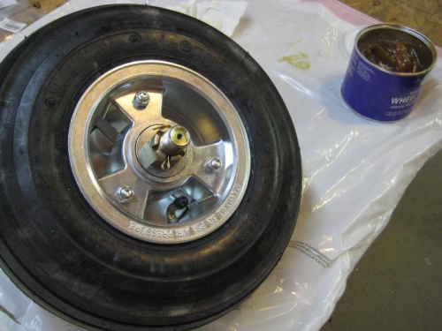

- Packed the wheel bearings and installed the wheels, brakes, retaining nut and cotter pins. Sheet L01 is now complete.

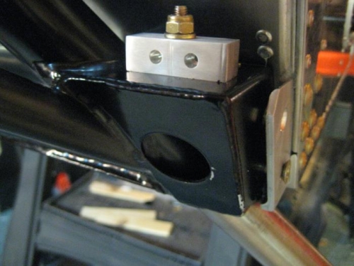

- Located, drilled for, and secured the block for the brake cables. On a tail dragger it gets mounted to the engine mount (photo #2).

Wheel bearings greased, and wheels/brakes installed.
Block for brake cables, secured to the engine mount.
