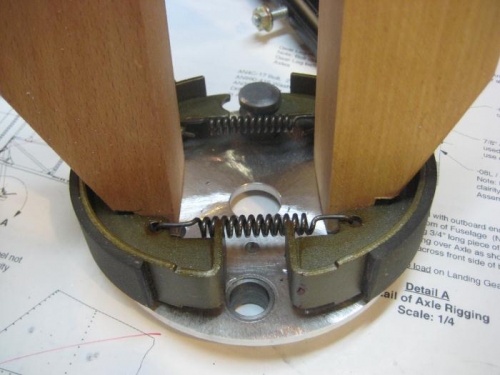

- To spread the brake shoes I bought the old style wood clamps, cut notches at the OUTSIDE faces, and UN-screwed the clamp to spread the shoes apart.
- Removed the rotating cam that makes the shoes spread out when the brakes are actuated.

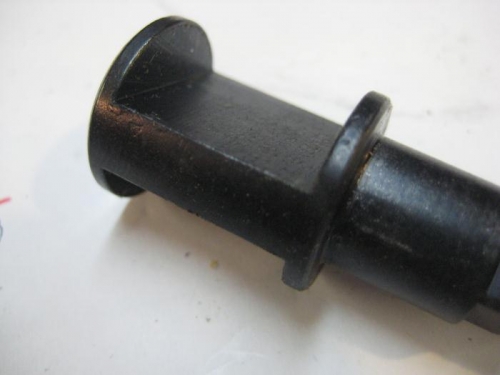

Other builders have noted that the sharp edges don't let the brakes work properly and fully, so rounding off the sharp corners appears to fix that.

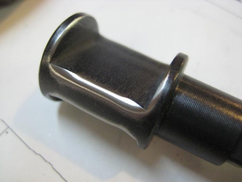

- So I got in there with my Scotch Brite wheel and ground off the corners as in photo #3.
- After putting the cams back in place, they did seem to work very smoothly.

Using wood clamps in reverse, to spread the shoes.
Brake cam as delivered.
Brake cam with corners ground off.
