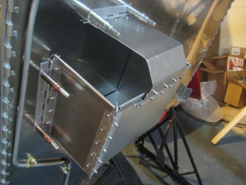

- With the engine mount in place, I located the battery box and marked it with a sharpie, including the first hole to be drilled, along the bottom flange of the box.

- Now I put the battery box on with a cleco in that single hole, leveled the box, then marked for the hole at the opposite end. Removed the box and drilled that.
- Cleco'd the box in place again then marked for the next holes; the ones between holes 1 and 2.
- Repeated the above process over and over until all the holes were drilled.

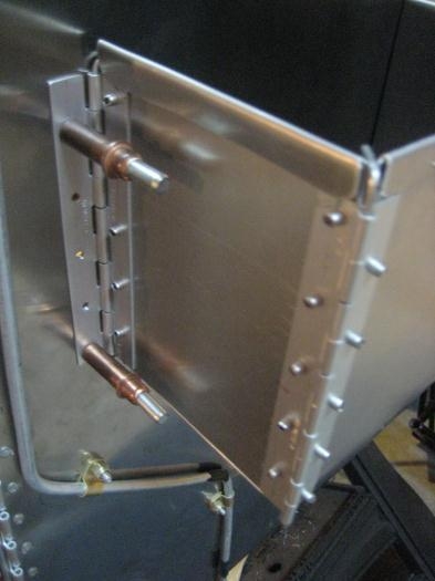

- I waited until I got all 3 flanges cleco'd before I made the cover strap, so I knew how long it really neede to be. Made the strap and set the first hinge on the box, then the one on the strap, and finally the ones on the fuselage.
Installation in progress
Side hinges are for removal so the battery can be taken out sideways.

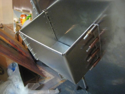

Closeup of the hinged corners.
