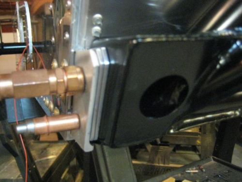

- Made all my last minute tweaks to the mount, and clamped in place.
- Pilot drilled through the motor mounts, shims and engine mount all in one shot, using the existing motor mount holes.
- Cleco'd everything in place.
- Updrilled all 8 holes to size.
I also got my titanium landing gear legs today, from Titanium Joe's. Heavy suckers!
Upper left mount pilot drilled
Lower right mount pilot drilled
Upper right mount after up-drilling to size.
