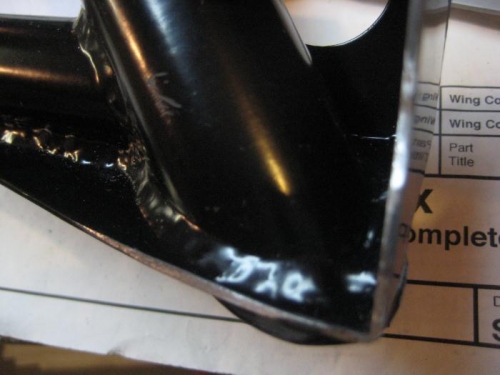

- To get the engine mount against the firewall I had to file away some of the top of the upper right mount plate of the engine mount, and also some of the lower horizontal plates at the lower engine mount (photo #2). I also had to relieve the back of the lower right mount because it was hitting two of the firewall rivets.
- I will prime and paint all the filed areas after I get the mounting holes drilled.

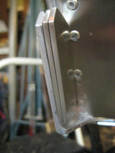

- To get the shims to stay in place as I wrestle the mount onto the fuselage, I used double-sided carpet tape to tape the shim layers together, and to then stick them to the fuselage motor mounts (photo #1).

Shims held with double-sided carpet tape.
After gringing down some of the engine mount material.
