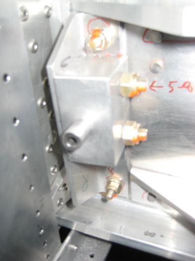

- Inserted the drill guide in the left wing blocks, until it hit the forward fuselage attach angle at the forward edge of the spar tunnel.
- With the guide in place, I drilled through the spar tunnel and the attach angle in a few seconds. The hole in the attach angle can be seen in photo #2.
This under-sized guide hole in the spar tunnel and attach angle are now perfectly centered on the 3/8" wing block holes, and can be updrilled after taking the wings out and putting them away.
- We did the same thing on the right hand side.

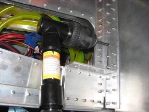

- Photo #3: Now we used the new holes in the FORWARD attach angle and the FORWARD spar tunnel, with the drill guides inside the spar blocks, to back-drill through the REAR spar tunnel and REAR attach angle.
This again gives us under-sized guide holes in the spar tunnel and attach angle that are now perfectly centered on the 3/8" wing block holes, and can be updrilled after taking the wings out and putting them away.
- We removed the clecos and removed the REAR attach angles and REAR spar tunnel assembly.

Drill guide inserted into left wing blocks, from rear to front.
The resulting under-sized (#13) hole through the FRONT attach angle.
On the right side of the fuselage, looking front to rear, drilling the revese under-sized hole.
