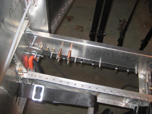

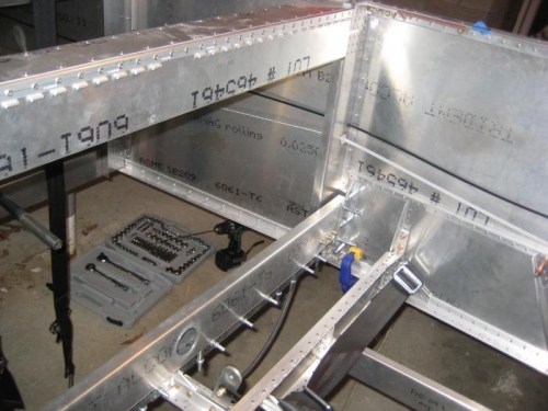

- In photos #1 & #2 you can see the clamps that are holding wood blocks on the outside of the fuselage, under the rear wing root, to support the wing and set the angle of incidence.
- Located the carry through, which already had holes in it, with the rear spar fittings. With just a little wiggling of the wing roots, THE DAMN THINGS WERE ALIGNED!!!! This is a scratch built airplane, and the damn things ALIGNED!! How does that happen?
- I put temporary bolts through the holes, then set, pilot drilled, and cleco'd the F03-08 Shear Angle and the F03-06 Attach Fittings.
Rear spar carry through on the left, rear

Rear spar carty through at the right, rear
