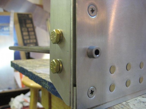

Finished making the guide rod that will be used to drill centered holes in the fuselage wing support angles. After the 11" long rod was sanded down to fit through the wing block holes, I cut it into two different lengths.
Now all I need is some good weather to bring the airplane outside for the rigging. This weekend's weather is supposed to be lousy.
3/8
3/8" rod with #13 hole, set through wing blocks.

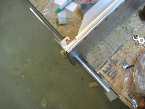

From above...
From above...
