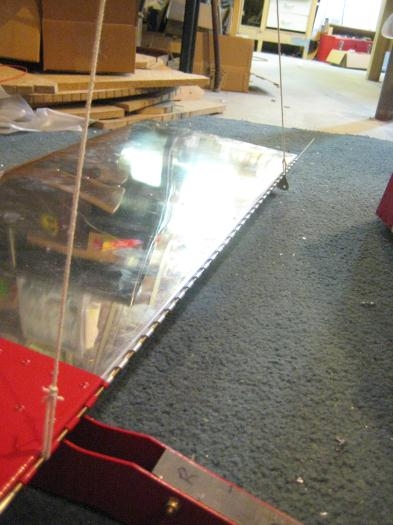

- Made a string with loops in both ends.
- Thread hinge pin so 1 loop was at each end of the aileron.

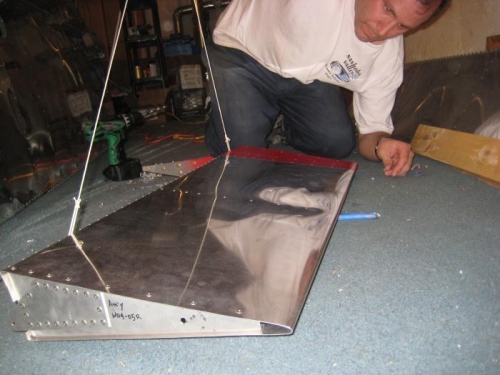

- Raised the aileron until it was just a hair off the floor, and I could see the trailing edge was level.

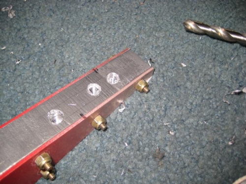

- With a 1/2" drill bit (with tape so it didn't mar the aileron) under the trailing edge, I drilled out the lead until the trailing edge bumped the drill bit. Then I knew it was 1/2" (max) per the plans. Actually it's probably 1/16" or 1/8" less than 1/2", since I needed to see a little daylight under the leading edge to know the aileron was off the floor, and level across the leading edge.

Hinge pin with string at 2 points
While holding the leading edge, put a 1/2
While holding the leading edge, put a 1/2" drill bit under trailing edge.
3 holes drilled in lead until balanced
