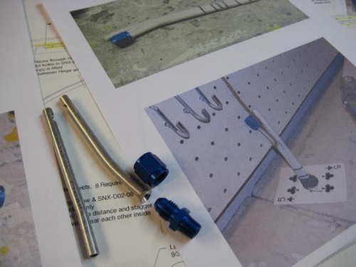

As others have done, I'm making a custom fuel vent that will allow me to fully fill the tank, vent the tank, but not let fuel coming out of the vent spray back on the wind screen. To do that:
- Take two pieces of vent tubing, cut holes in the ends, facing one another (photo #3). I did this with a round rasp file, then finished with a fine file and sand paper.
- Bend the ends of both pieces (one more than the other) - (photo #1)

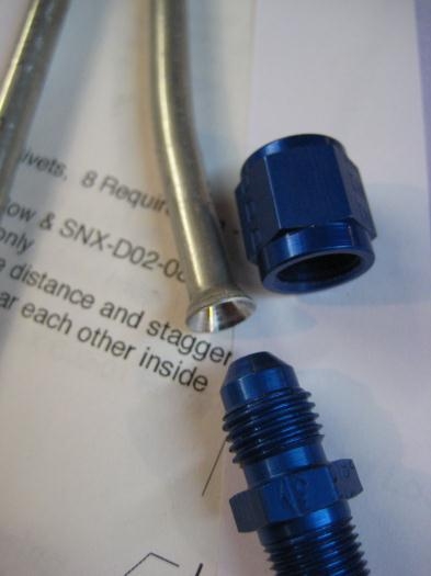

- Flare the end of the one with the largest bend (photo #2)

2 fuel vent lines, bent
Flared for AN fitting
