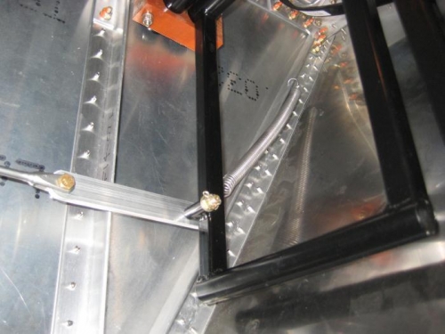

Left rudder cable
Installed the left rudder cable to the rudder pedal.

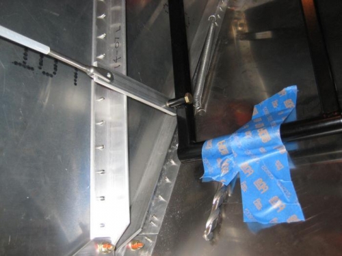

- Used a 3/8" drill bit to set the 3/8" distance off the firewall (photo #1).
- Marked the location of the clevis hole on the aluminum rudder link.
- Removed the link, drilled the hole and deburred, then cut and rounded the end of the link.
- Installed with bolts and cotter pins per plans.
- Attached the rudder return spring.
Used a 3/8" drill bit to set the 3/8" off the firewall.
Rudder cable and return spring fully installed.
