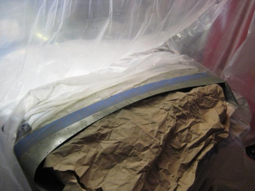

Prep right wintip for paint
- Finished taping off right wingtip for paint
- Prep'ed the aluminum: 300 grit sandpaper, Scotchbrite pad rub-down, clean with mineral spirits, wipe with tack cloth

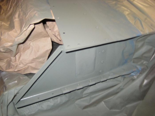

- Applied 4 light coats of self-etching primer to 3 of 4 faces
1st, light coat of primer.
After 4 thin coats of primer...
