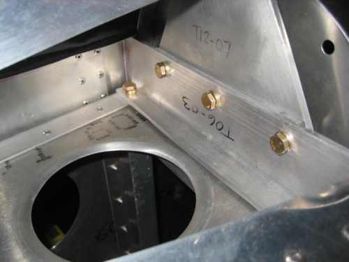

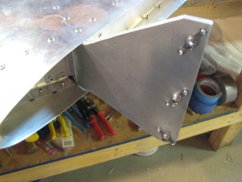

Bolting down vertical tail
- Installed the 3 anchor nuts in the forward face of T12-07 of the vertical stabilizer (photo #1), set with countersunk rivets at aft face (photo #2).
- Aligned and cleane up all the holes in the vertical tail post, including deburring.
- Set the tail by torquing the 3 forward bolts and cleco'ing the tail post (see single photo on next page).
- Began loosely installing the tail post bolts (see photo on next page).
Forward face of T12-07 with anchor nuts
Aft face with countersunk rivets
Forward section of tail secured with 3 bolts into the 3 anchor nuts
