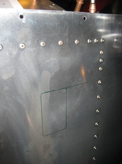

- Then spent the night working on the Van's (yes, that "other" airplane company) fresh air vents. I used the dimensions from another Sonex builder that installed these, to locate them on the side skin. It looked like a good position and they cleared the flap handle in his photos, so I went with them (3-7/8" down from the top of the skin (photo #3), and 2-9/16" forward of the centerline of the rivets in photo #3).
- Following the Van's directions I used countersunk rivets. But I used SSC-32 pulled rivets instead of bucked rivets.
- I then used the piece that would become the new exterior vent door and traced that at the dimensions noted above. I then drilled starter holes and used nibblers, a file, and sand paper to finish the hole to size.

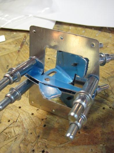

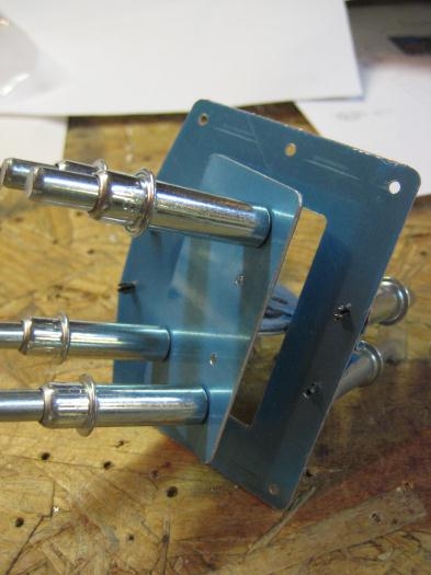

Pieces all cleco'd together, as seen from the outside
...as seen from the inside...
Using the piece that will become the exterior skin of the vent I traced it onto the skin
