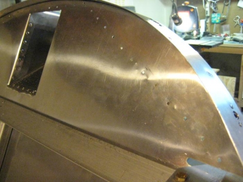

- Finished drilling the holes in the stainless. If I used a very short bit, set my cordless drill on slow speed, and pushed like hell, I could punch a hole fairly quickly... IF the bit didn't break. Even short bit would break with the wrong angle an pressure.
- Updrilled all the holes

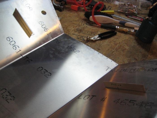

- Located and riveted the two fuel tank stop angles underneath the glare shield (photo #2).
Holes in stainless firewall completed (glare shield removed)
Fuel tank stop angles
